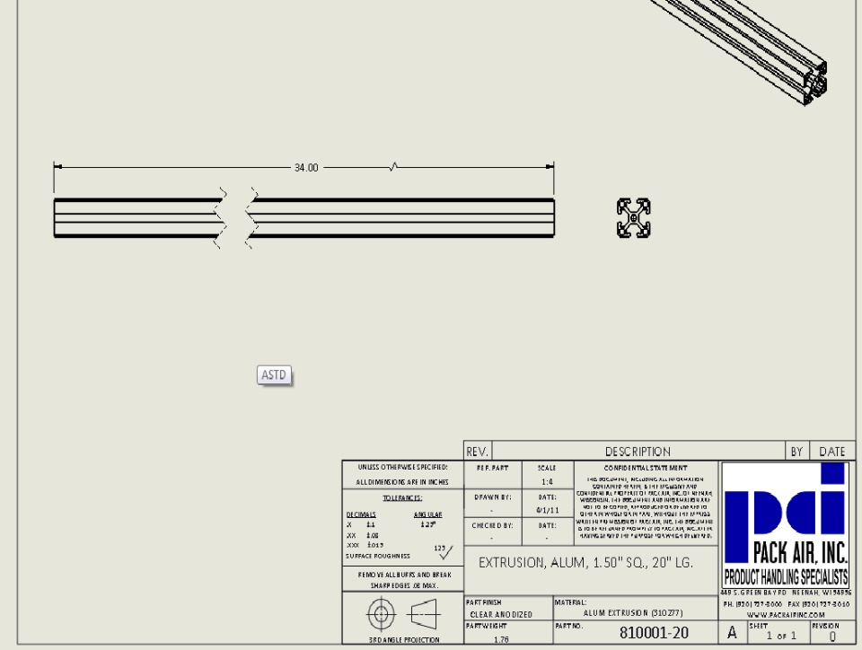

Is it possible to have your drawing view maintain the size when using a break dimenison. I have attached a sample drawing. I would like to set up pre-defined views for this drawing. The catch is the part model is a configured part with lengths ranging from 4" to 235" at random. I would like to set-up the "RIGHT" & "ISO" views to maintain the
default configuration and the "FRONT" to be used for the configuration and use a broken dimenison for its overall length.
I've tried the "lock view focus" and "lock view position", I want to maintain the size of the view no matter the length. How can you produce all the drawings for all the configurations automatically?
