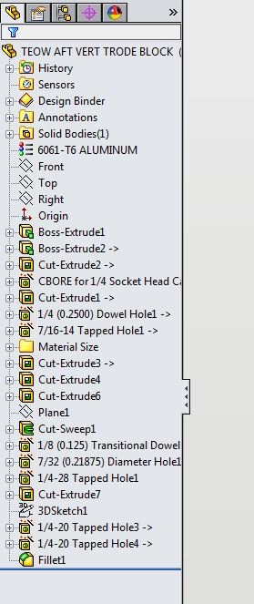

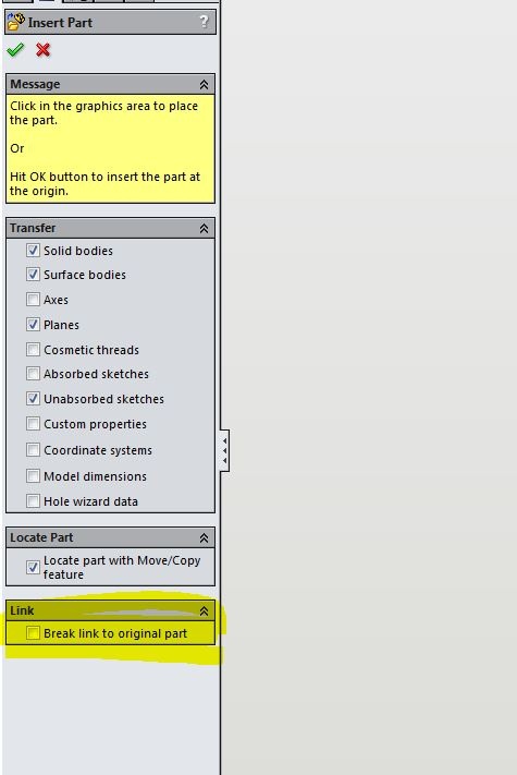

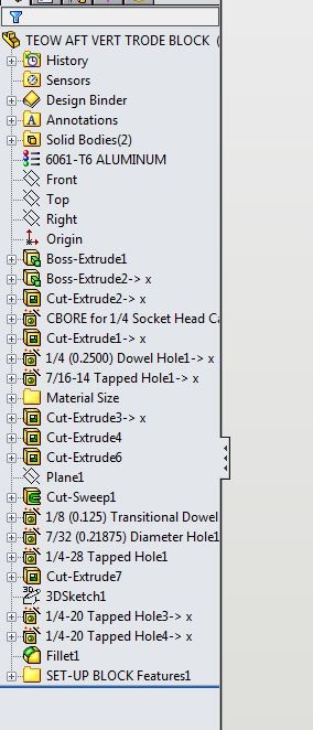

Why does Solidworks break ALL the external relations in your existing part when you do an INSERT > PART > & toggle the Break link to the original part to on. Shouldn't this break all links to the part that you're inserting into a part rather than those of the part you're inserting it into. Makes the toggle almost useless IMH.
