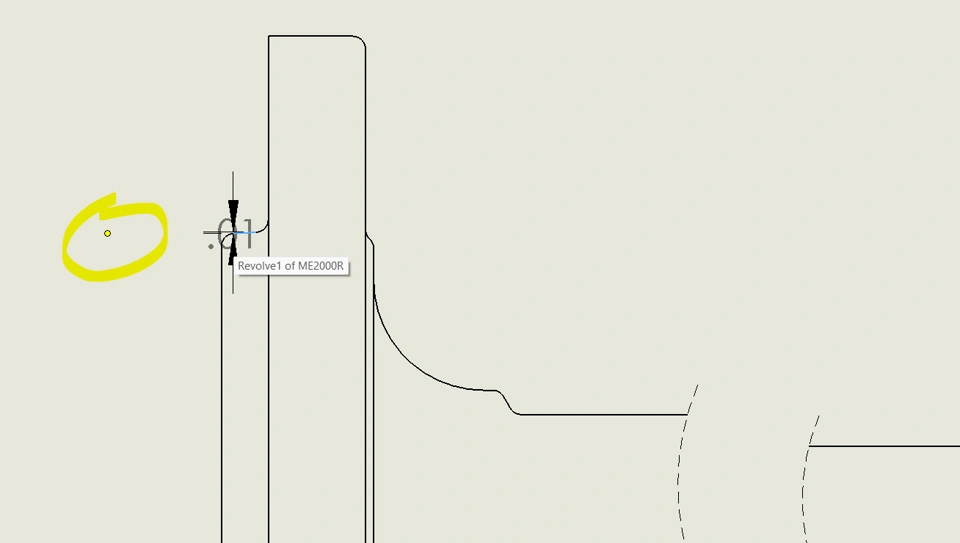

Using Smart Dimensions, I am able to create an Angled dimension using imaginary lines.  In order to do so, an end point or vertex needs to be selected.  This all behaves as intended until I add a Break View in my drawing.  The part shrinks in length but the place where the original end point (vertex) was remains in its original spot.  I have duplicated this on every instance of solidworks in my office.  Even a clean install does the same thing.
NORMAL behavior without a break view - Vertex is selected and crosshair appears on the vertex
AFTER break view - Old vertex remains in original spot while hovering over new vertex position.
This particular part is shortened by about 35" after break view making dimensioning in that state impossible.
