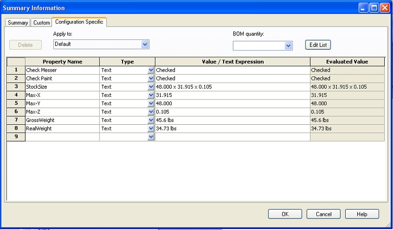

The last few days I had questions about a bounding box macro and I have tried a few this morning with mixed results. One thing I noticed is the macro result is put into the configuration properties not the custom properties.

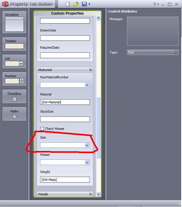

Here they want the overall size of the part on the drawing (see attached). In my Custom Properties Builder I have a List Box where I type in the Size

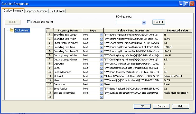

3. Right Click on the Cut-List-Item1
4. Select Properties then the bounding box pops up
5. Hand write the Bounding Box Width & Length
6. Go to the Custom Properties tab
7. Select the Size
8. Input the hand written info (Human error or fat finger disease comes into play here)
What I was looking for is the macro to read off of the Sheet Metal Gage, using the bounding box width/length, (instead of x,y,z), and returning those values to either StockSize or any thing else.
