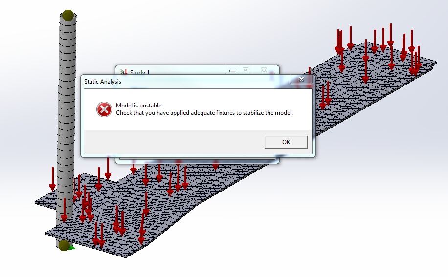

I'm trying to run a model that contains beam and solid elements.  I've greatly simplified what I'm actually analyzing to figure out why my contact sets between a beam and a solid are not working.

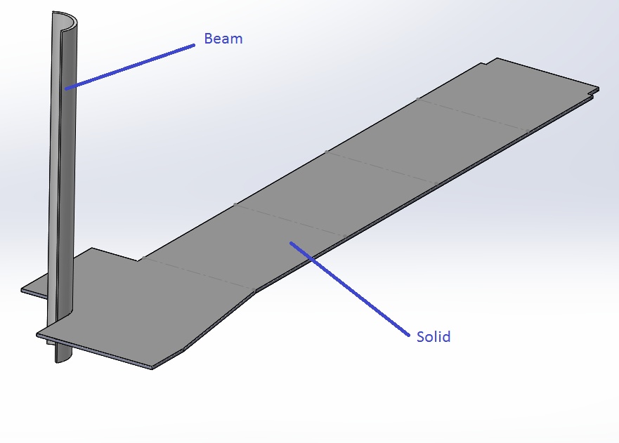

I have a large beam cylindrical beam standing vertically and is fixed on it's bottom joint.  I have a plate constrained to the cylindrical face of the beam via contact set (it's also constrained in the model).  It meshes completety fine.
When I click solve, I get an error that says:  "Model is unstable.  Check that you have applied adequate fixtures to stabilize the model"
I don't understand why.  The only part that has a fixture is the beam.  The plate is bonded to the beam and cantilevering out from the cylindrical face.  Why isn't the bonded contact set creating a "weld or adhesion" that makes the solid and beam move together?

The original way I set up the contact set was Beam to Face (solid).
This gives me no errors.  But when I run the simulation, it says the model fixtures are causing the error.
If I put a fixture on any face of the solid, the simulation runs fine.  The problem is, there aren't any fixtures on the solid for the problem I'm trying to analyze.  For some reason, even with the contact set in place, Solidworks is analyzing the solid as a free-free boundary condition...

The exact error message is:
Model is unstable.
I am running SolidWorks Premium 2013 x64 Edition, SP4.0

I applied a fixture to the cylindrical edge of the solid plate component that is bonded to the beam face using the Reference Geometry in the Advanced Fixture dropdown.    What it appears this does is it fixes the face of the Solid to the face of the Beam.  I applied very small rotation and translation (zero axial however) :
After doing this, the displacement looks a lot more realistic:

May have discovered a solution to this problem, especially when running an analysis with beams and solids.
Found this thread which pointed me in an interesting direction:  https://forum.solidworks.com/community/general/blog/tags/beams
For analyses with the joining of beams and solids, it's ideal to place fixtures on solid components.  For some reason, when the fixture is applied to the beam, Solidworks does not analyze the assembly correctly and disregards contact sets.
I ran the model again, but edited the cut out part of the plate (selected a smaller diameter), and mated this to the beam component to create an intentional interference.  Comparing the analysis:
So, does this mean in order for a beam to constrain and keep this specific type of component contact, you must create an intentional interference between the parts???  Strange...
