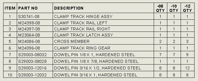

This is how I want the parts displayed. I will edit the Part No to show -XX for items 1-6. I manually created the last two columns.

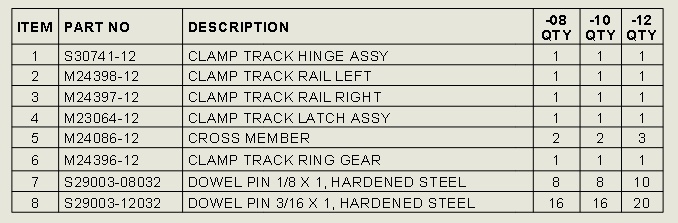

This BOM displays all configs of a part as one item. That is great for items 1-6 but not good for the dowel pins.

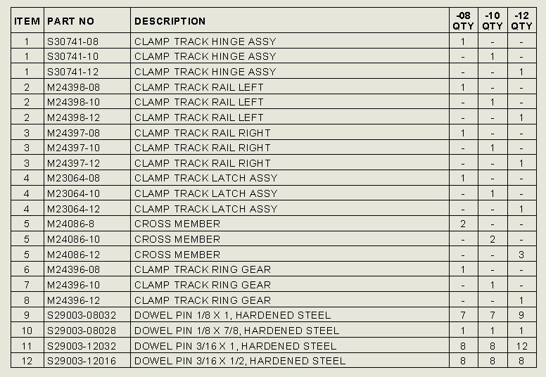

This BOM displays all configs of a part as separate items. That is great for the hardware but not good for the rest of the parts.
