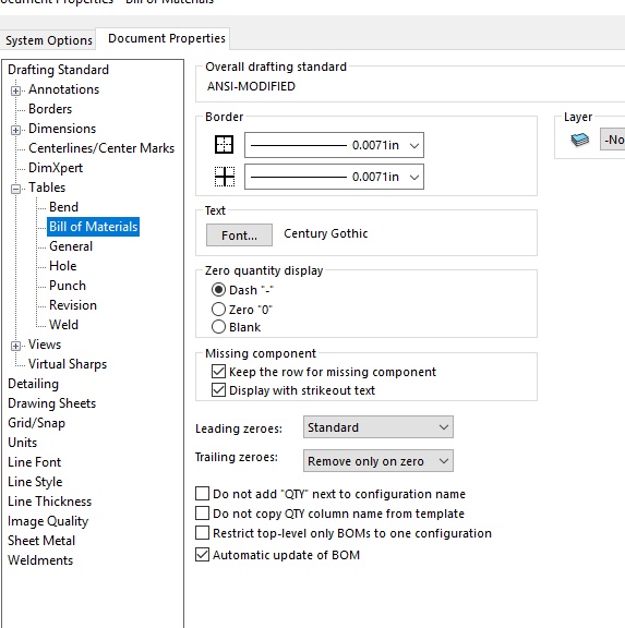

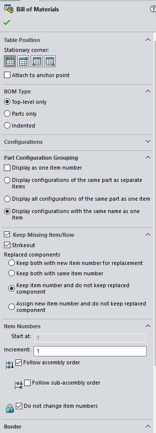

BoM STRIKEOUT/ STRIKE THROUGH NOT WORKING
As the subject mentions, if I delete an item out of the assembly file, the line item (row) in a BoM gets deleted and does not strike out/through. Both (images for BoM control) are set to do so before I remove the part. Seems conflicting what controls what...
We are TRYING to MOVE TOWARDS be implementing the use of strike out instead of line item deletion... IF IT WORKS.
