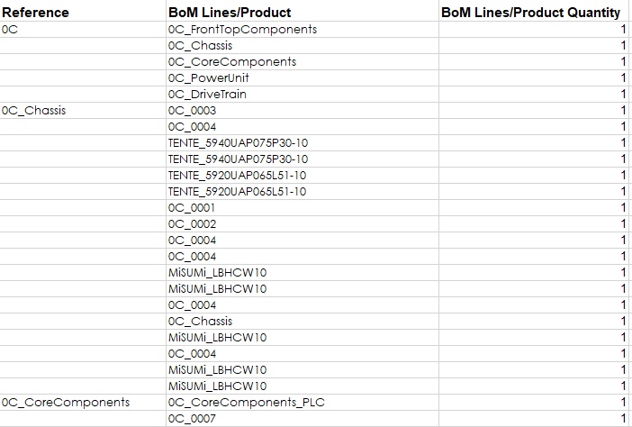

I'm looking for a way to get the pictured BOM with correct Quantities.
The BOM should only show TopLevel components.
If a component is an Assembly, it should get a separate TopLevel BOM underneath.
My example: "0C" consists of 5 subassemblies. The "0C_Chassis" BOM follows underneath.
My problem:
The way i do it (two For-loops after each other going through all components), it does not merge identical components.

Question:
A) Is there a simple way to get the amount of a component?
I usually get the components of an assembly via:
Set swBOMTable = CompDoc.Extension.InsertBomTable3(BOMTemplate, 0, 0, BOMType, ConfigName, True, BOMNoType, True)
Set swTable = swBOMTable
This way you also get the amounts and no duplicate lines.
Problem: you cannot call "CompDoc.Extension.InsertBomTable3" on a child component.
It throws a "serious error" and leads to Solidworks crashing ungraceful..
Hence this option would only work for the first TopLevel BOM but not for the SubAssy BOMs.
Question:
B) is there a way to create a BOM for a Subassy that is not opened and active or do I need to go the way of option A?
