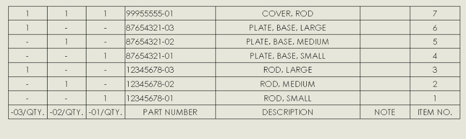

I'm getting a weird thing happening with our BOM table.  As a test, I've created a BOM with 3 dash numbers. Everything was fine.  I added

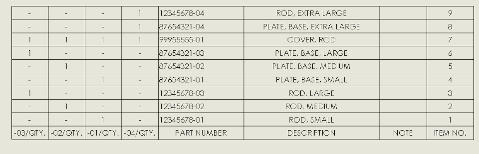

another dash number (-04) and it was inserted to the right of the -01 column even though my family table is set to in reverse from -04 to -01 so it will
display on the drawing from right to left.  So, I dragging the -04 column to be to the left of the -03 column. Then I re-saved my BOM table even though I didn't need to.

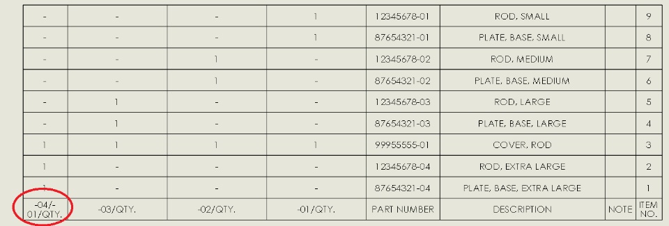

Next, I deleted the BOM from the drawing and re-added it, and the columns shows as correct from -01 to -04 from right to left after selecting all the configurations in the BOM Property Manager.
Now, the -04 column shows as -04/-01.  Has anyone seen this phenomenon??  If so, how can I fix this??  I know I can just delete
the /-01 from that column.  But, it gets even weirder.  I added another dash number (-05).  But now that displays as -05/-04/-01 and the -04 column is fine.  Only the most recently added column is affected.
Did this happen because I re-saved my BOM table after dragging the column??
ORIGINAL BOM
ORIGINAL ADD OF -04
AFTER RE-ADDING THE BOM
