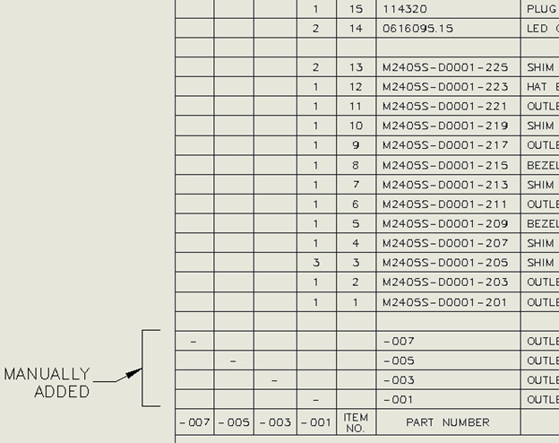

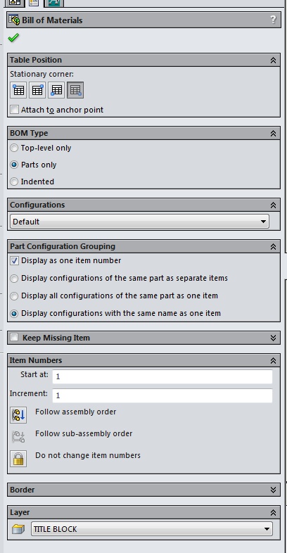

I want to show only parts in my BOM, but I have four configurations. When I choose Parts Only, it only let's me choose one configuration.
Is there a way to show the parts in each config?
-001, -003, -005, -007 are the configurations.
I added the bottom four rows manually, and I added the config columns, 003, 005, 007, manually. Keep reading for a screenshot of my model's Feature Tree.
How my model is set up
There are four subassemblies, each one corresponds to a configuration. I have another configuration with all subassemblies unsuppressed to show all the parts in the BOM.
