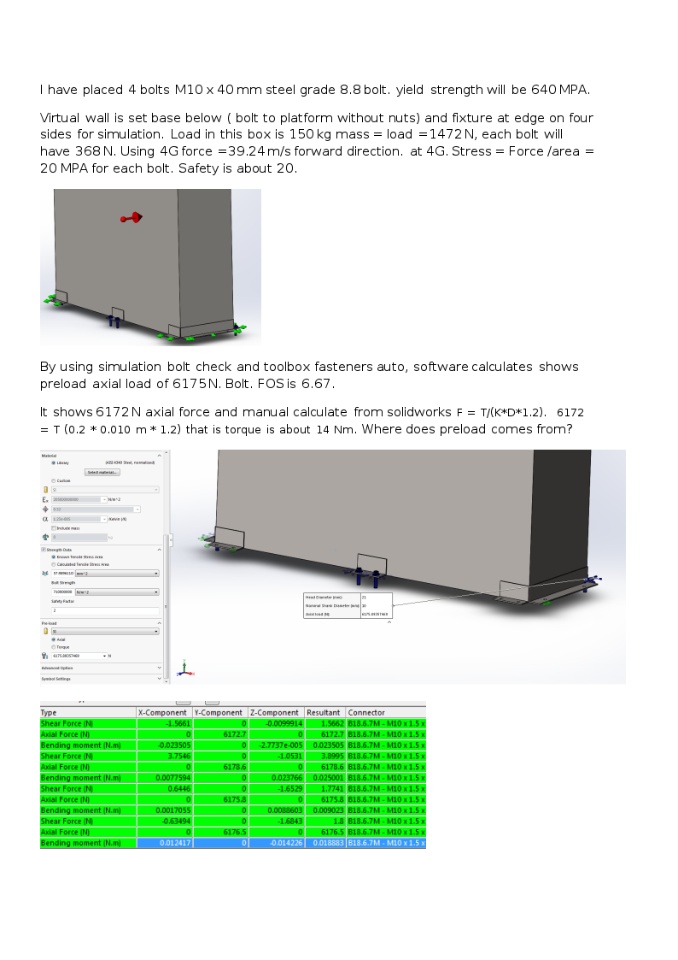

I have queries on bolt tie-down to platform and attached as shown. How does no. of bolts help in this simulation since the results show individual FOS bolts regardless the load input 150 kg at 1G or 4G or 12G. Only the box stress and displacement are affected.
Bolts are torque since it is without nuts to secure.
