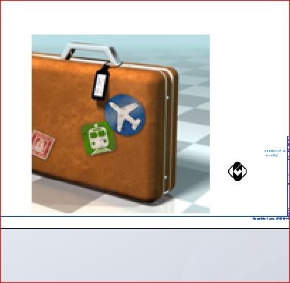

Attached are screen snips of the file (while opened as a sheet format) in SW and then after saved as .dwg in DraftSight.
