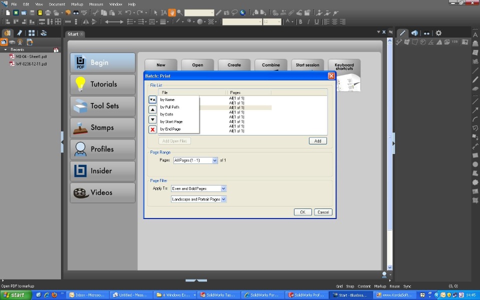

Now, I have download Bluebeam®PDF Revu® trial version.
I am very pleased with the software. I can batch print in numerical order, chose the printer and the paper size.
