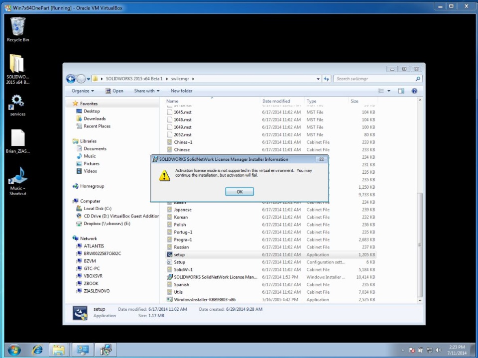

Hi guys,
I noticed when trying to install the swlicmgr on my VM that we are now blocking activation of SNL on virtualized platforms:
I agree this is important to prevent cloning of activated servers to illegally increase license count. I also
However, I also know that the majority of customers I talk to who use SNL do so on a virtualized platform. From what I know, IT professional these days choose a virtualized server environment over physical.
How are we going to respond to the huge number of IT groups that will be S.O.L. when they try and upgrade to 2015 SNL for their engineers?  Or will this be on the channel and customer center to fulfill license file requests?
