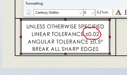

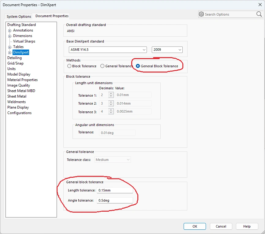

I'm working on a drawing template that displays some properties from the part. I created a sample part, selected general block tolerance, and input the values I want.

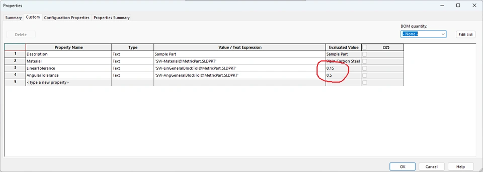

I created some custom properties tied to these values. The correct values appear there.
In the sheet format, I inserted this custom property into a note. The correct values appear again.
The instant I click OK in the link to property dialog, the value gets divided by 10 and rounded. It does this with any value I set in the part.
Ummm... what?
