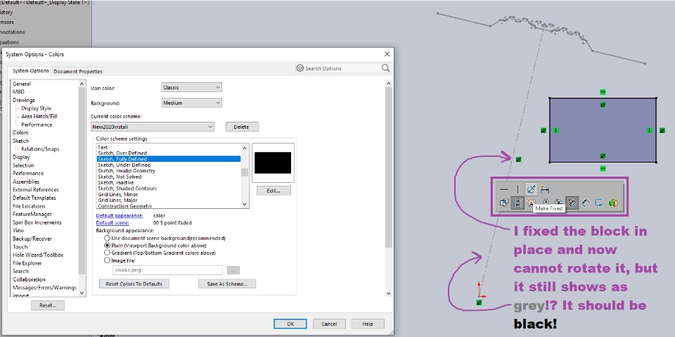

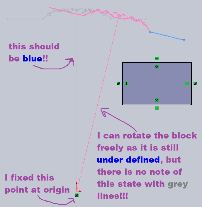

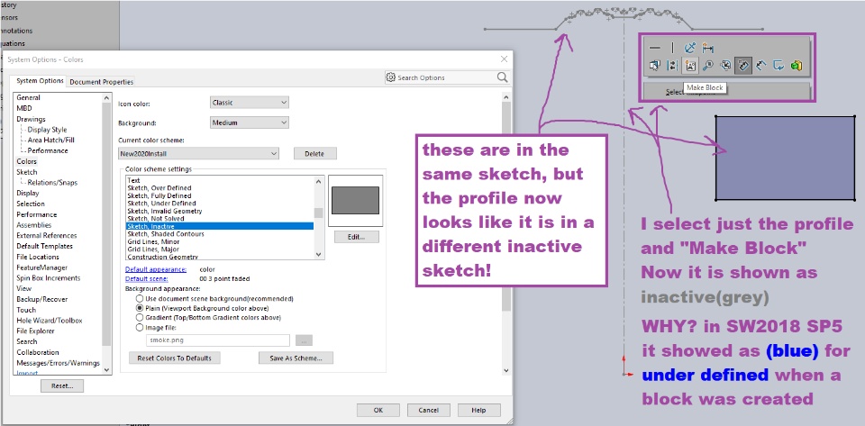

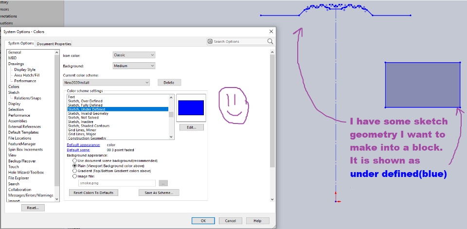

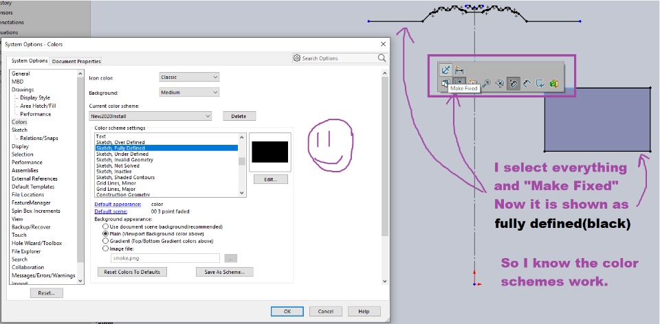

I upgraded to SW 2020 SP5 and am having an issue with block colors in sketches.
The block color is grey(inactive?) and does not indicate defined state; neither under defined(blue) nor fully defined(black).
I have already had this issue and solved it back in 2018 ...but I can't read my old post fully to see if I got help on the forum or not.
https://forum.solidworks.com/thread/227689
Does anyone know how I can make my blocks follow the color scheme for sketch geometry? I could not find a color scheme setting specifically for blocks.
A block in an active sketch shows up as grey, like it is in an inactive sketch in the background. I cannot tell if my blocks are fully defined or under defined, nor tell an active sketch from an inactive sketch when they only contain blocks.
