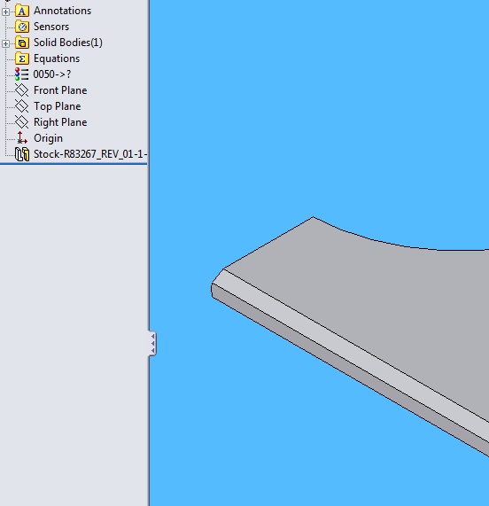

here is an image of the feature tree of the part so you can see what I am talking about. These parts are typical not located at the origin and are not parallel to the base planes since they are all driven.
