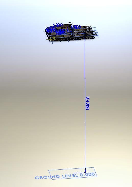

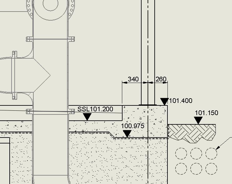

Attached are two images.
To generate the levels on my drawings so that they all update when the model elevation changes, I add some text and then click on a vertical dimension on my drawing view. (I have a view outside of the extents of my title sheet that I use to grab the dimnensions.)
Next I override the units from mm to m. I then block the text with a little black triangle.
