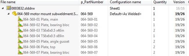

Example of a part with 2 PDFs I want to send to ERP, and what is already in EPDM:
Weldment with 2 separate drawings (only one shows in Where Used tab):
Other drawing shows weldment in it's Contains tab:
And the 2nd PDF I want to send to ERP is in it's Where Used tab:
