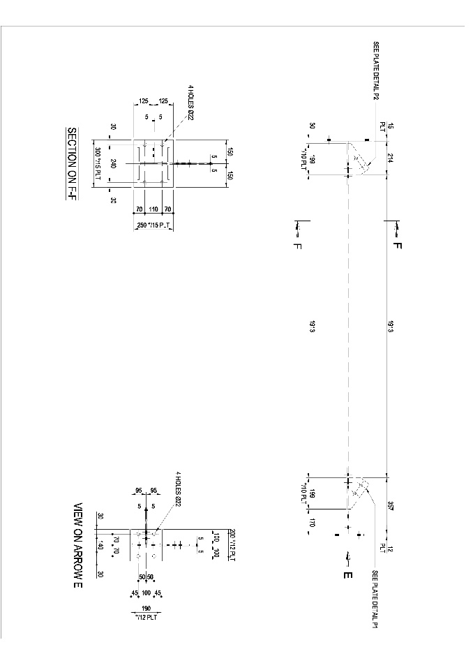

With producing detailed drawings of structural members and end plates in mind I have applied the philosophy of separating parts based on how they will be fabricated e.g. a beam with 2 welded end plates would be 1 part and another part could be multiple members welded together for example a welded angle flange.
I have considered using the cut list feature in the drawing view to produce drawings however, unless I have missed something this wouldn’t account for end plates & holes in members, so this approach has been benched for now.

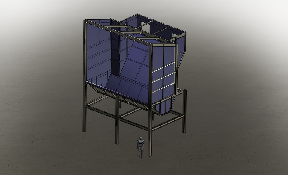

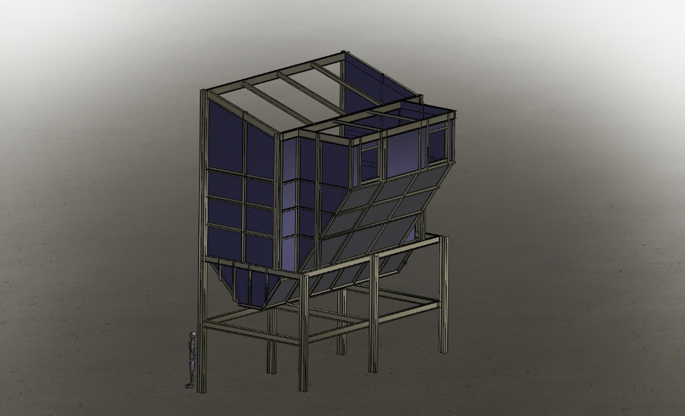

Attached below is a picture of the hopper which I have modelled top down using a layout sketch. This is only the outline design which now needs detailing up, my main concerns are how to approach: standard beam notches and cuts, end plates and holes with relations between parts and platework with bolt holes with relations between parts.
