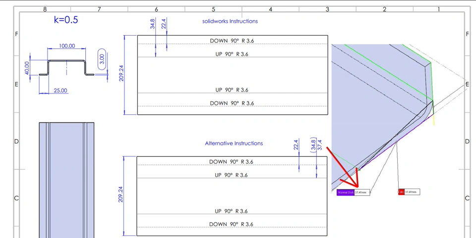

Hi
Picture attached
I find that if I give the press bending machine operator the "alternative" instructions the folded item would be more accurate to the model, but I guess I doing it wrong.
What's the right way to do it?
I told him to use 22mm die on the machine for 3mm thick plates
