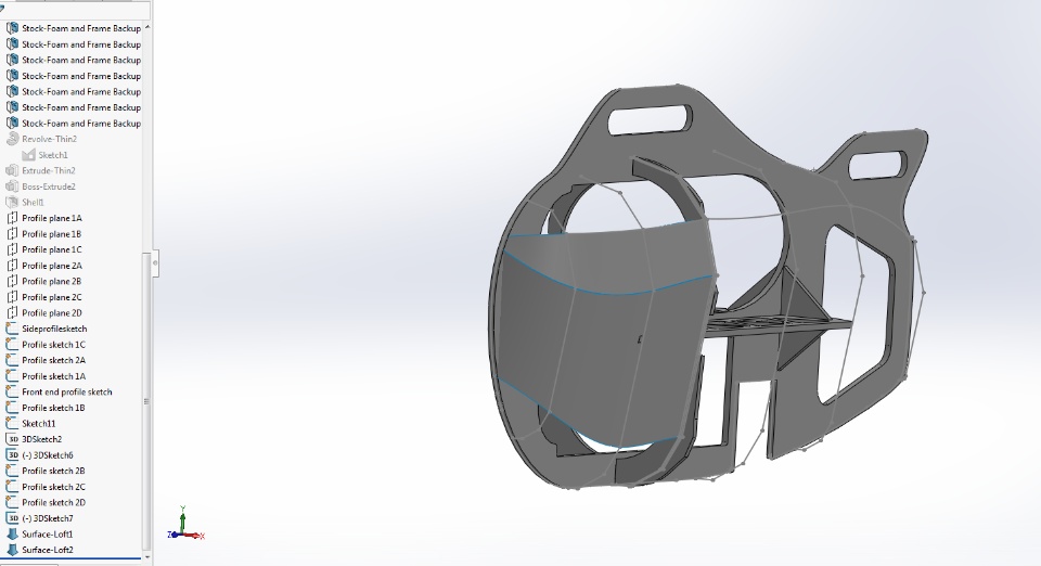

I'm designing a small AUV for a company and I'm a little stuck on the shell of the vessel...
The shell is gonna be made of PEHD sheets bend from forward to aft section like a carvel build boat, therefore I need the sheetmetal feauture flatten to make the cut drawings for the PEHD sheets.
The problem is I first made all the profiles and was then gonna drag splines from profile to profile in order to get the lines to make a lofted bend from. But the lofted bend doesn't take splines as input... any good inputs as how I can get around that issue or design in a smarter way??
I do not have much boat designing experience so I'm all ears :-)
I've included a couple of picture of my intentions, they are still most sketches...
Thanx guys
Martin

Hi Martin
Looks nice project
you say "But the lofted bend doesn't take splines as input"
I can use Splines to make Lofted Bends.  What version are you using? Can you upload an example of the spline sketches you'd like to use

Hi Rob
Thanks :-)
Figured why it wouldn't take the splines as input...forgot to change to free formed rather than bend (lofted bend)
Just couldn't get my head around that problem and was trying every trick I knew to get around it! :-)
