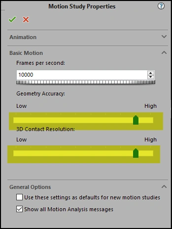

I am trying to run a Basic Motion study to show a ball bearing traveling through a series of passages inside a part.
The issue, as you can see, is that the ball, once it passes through into the interior passage, just goes straight through the rest of the part.
My expectation is that the ball will bounce off the back of the hole, then fall down toward us in the last view of the GIF file.
I know that SOME of the contact is working, because I changed the direction of gravity slightly so that it "bounces" off the sides of the hole it is falling through.
Things I have tried already:
1) I read that increasing FPS can help with this.  Well, I tried a bunch of different numbers: 60, 100, 500, 1000, 5000, and 10,000.  All with the exact same result.
2) I read that decreasing gravity can help.  So I changed it from the default to 10in/sec^2, then tried 1in/sec^2.  Both with the same result. (then brought it back up to 10 for the video above because 1 was too slow)
3) I read that using the standard materials instead of custom material for the components can help, so I changed the materials to Alloy Steel on both components
4) I read that increasing accuracy can help, so I maxed out both Geometry Accuracy and 3D contact resolution with no change in result.  Then thought that maybe I went too far and brought it back a tic, with no change.
5) A full reboot.  With no change.
