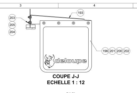

So, this is what it displayed when we had a short mud pad. 196 being the balloon that represents the mud pad inside the promoted assembly.

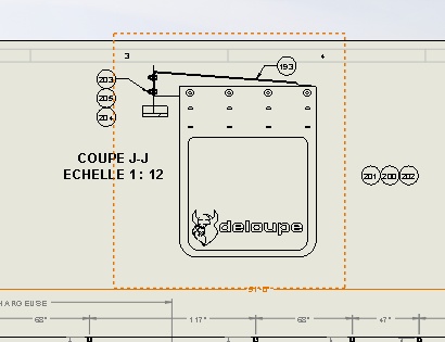

When we switched the configuration of the promoted assembly, this is the result in the drawing. The pile floats around.

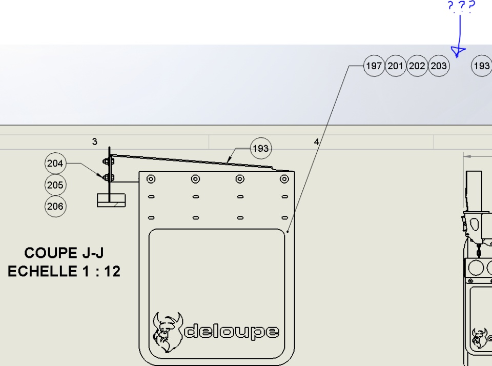

So you figure yeah, I don't want to lose time redoing all my balloons so I'll just add another baloon to the pile and have it be the leading one. Well, turns out the balloon that disappeared is actually still in the pile. Not only that, it is not selectable so it is not deletable either.
