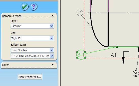

Balloon Settings→Item Number
Manual modification of part number, Item Number 3-1
But use code don't  modification Item Number
