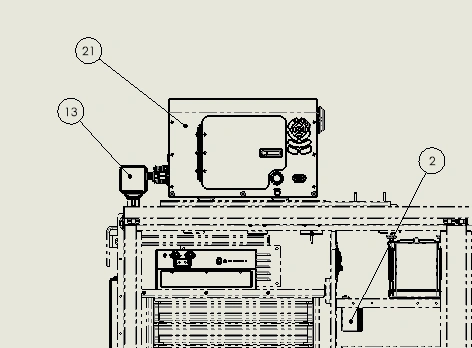

I use balloons to call out not only the item number, but the quantity of a part on my assembly drawings. I use the circular split line and circular balloons. My drawings have multiple pages because not all of the parts can be called out on the same page due to space and location.
The first page I use balloons on, works, quantity and item number. However, when I add balloons to the next page, the item numbers become all messed up. They show weird quantities and they don't match the BOM table. Is there something I'm doing wrong?

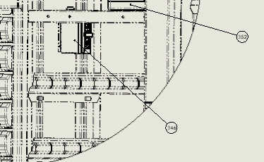

This is the same document, same parts, different views, but the Item number is now 346? I don't know where it's getting this number.
