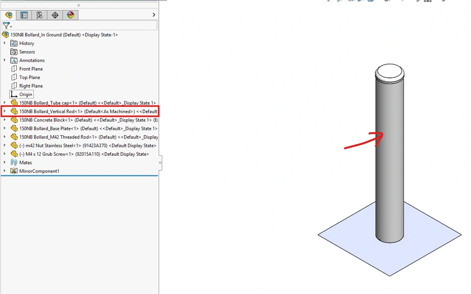

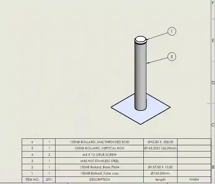

I’ve created a drawing of an assembly that includes an isometric view with balloons and a Bill of Materials (BOM). When I suppress a component in the assembly, its corresponding balloon understandably disappears. However, when I unsuppressed the same component, the balloon doesn’t automatically reappear.

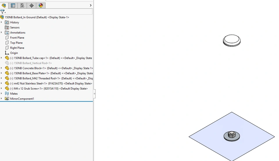

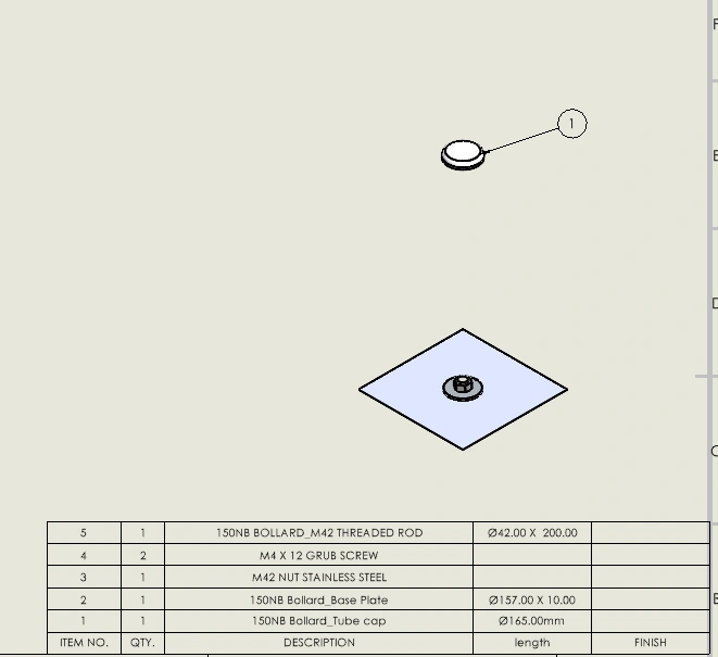

Suppressing the part, Balloon get invisible.

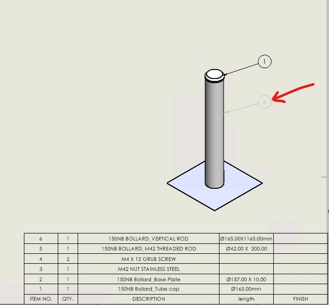

After Unsuppressed below image, Balloon remains invisible even after unsuppressed the part.
After investigating, I found that the balloon is actually hidden and needs to be manually set to visible again.
Is there a specific setting or option that ensures balloons automatically become visible again when a suppressed part is unsuppressed?
NOTE:- I also let you know this happens only when I have placed BOM on the sheet, If I remove the BOM & then after suppress-unsuppressed the part, It's balloon get visible automatically.
