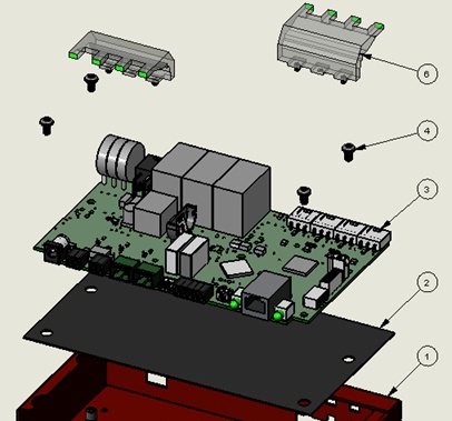

Balloon and note leaders do not appear attached to parts in drawing views with Perspective applied.
Drawing view without perspective:

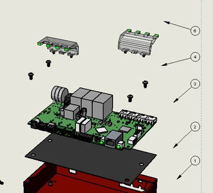

Drawing view with Perspective:
If I attempt to move the leader arrows, they lose connection to the parts. Also, the visible edges of the parts do not highlight when the cursor passes over them as you would expect.
Any ideas?
