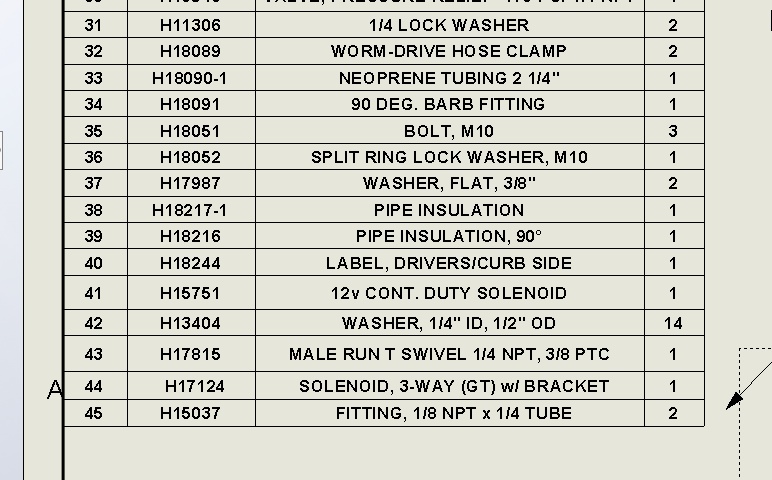

     I have a situation where a former employee set up a sheet with a major bom on the 1st sheet, & then individual boms on additional sheets matching the first.

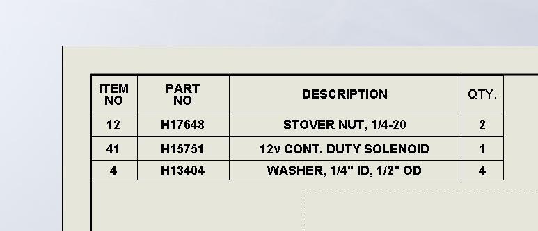

I find if I restore a hidden bom item, it goes to the next no. not the number from sheet 1. Like most I hate to have to overwrite the number, but is that the best I can do in this situation, or is there a way to link them?
    Specifically, item 42 the washer shows up on sheet one as item 42, but when I make it visible in the auxillary bom it shows up as item 4.
