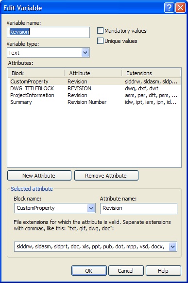

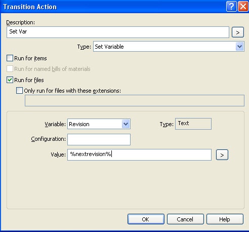

I am trying to configure a workflow to automaticlly set therevision of part, drawing, and assembly files when moved throughacertain transition. I am failing though. I find the admin guidesnot detailled enough and would like some help. Has anyone donethis? I also would like the revisions to appear on the drawingstitle block and in the data card. I believe my only mistakes so farare setting the revision control in the workflow.
