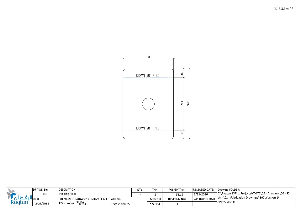

kindly i need your support , we daily create drawing for 200 parts minimum , wile process is always the same:-
  • Open Part.
  • Create drawing using Saved Sheet Format.
  • add flatten view with bend line and bend notes to sheet one.
  • add bend line dimension ,Bend line location dimensions as chain.
  • add another flatten view Scale 1:1 to the second sheet which has no sheet format. (without bend line, or bend line notes).
sure API can do this steps instead of the design , but due to my limited information about API so i don't know how it can be done.
please any help!
such API will save a lot of time to us
attached sample of created drawing
