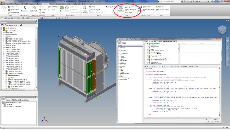

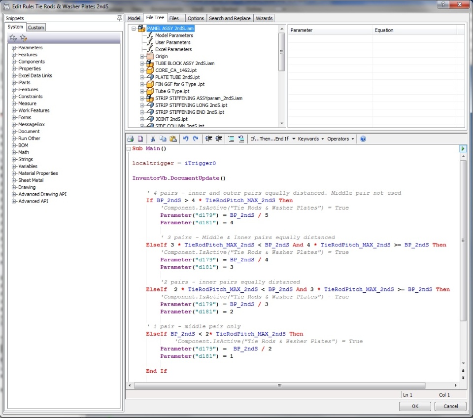

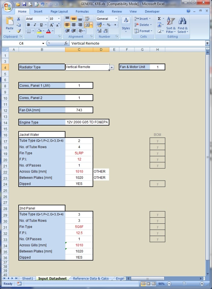

There is another discussion in AD Inventor Users Group about automated design and product configurators ETO/iLogic. We used iLogic & and Excel spreadsheet and developed a fairly complex configurator. See more here..
