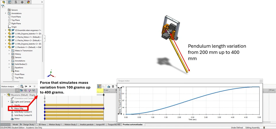

I designed a mechanism and want to analyze the torque behavior of a motor when I modify the length of a simple pendulum and the mass at the tip of the pendulum. So far, I've made the modifications manually (I open the pendulum part and modify the extrusion, lengthening the pendulum by 10 mm, and for the mass, I modify a force that simulates the mass of at the end of the pendulum from 100 grams up to 400 grams). In the image below, I show what I'm changing.
Is there a way to do all this automatically? I found that it can be done with global variables (pendulum length and simulated force) that can be entered into a design study, but I'm having trouble linking those variables.
