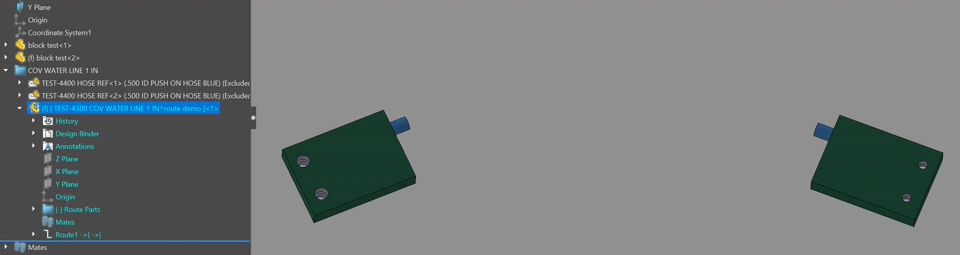

Is anyone else having issues with Auto Route in the routing add-in not working? I run flexible tube routes, and I use a macro to do most of the work. It will start a route and then try to auto route between the points. I use the "CreateRouteThroughSketchEntities" method. The return value is "0" which means success but all I get are the start and end of the tube? If I go back and edit the route there is no spline connecting the start and end points. Now if I try to use the "CreatePointToPointAutoRoute" Method I get the return value of 1 which means "swRouteTypeAndConversionModeMismatch". Not really sure what that is telling me? Do I have something set wrong in my routing data base? This was working fine for a few years and then just stopped working. I have it draw in a spline as a work around, but it sometimes gets the tangency wrong and auto route did not do that.
I guess the main thing I am asking is anyone else seeing this. If not and you use auto Route then what is your secret?
Here is the macro I am testing. This is the auto route section of a much larger standalone routing helper app I made.
if you want to test it you will need to make a flexible tube route like I have shown in the picture and have it preselected then run the macro to do the auto route.
this is basically a copy paste of the SolidWorks API help example. It ran great for years and then just stopped working I think in 2024 release. I am runner 2025 sp5 now.

This should tell you success but then does not show the tube.
