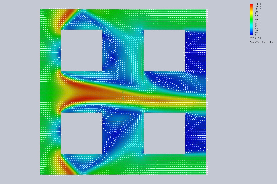

Hi there,
An assignment from the course asks me to explore how wind velocity looks like in an ideal block in Solidworks Flow Simulation. The graph posed below is a looking-down view, as four grey building studs make a block. Wind is blowing from left side only, and all other setups that I am aware of are symmetric, but the velocity field is not symmetric at all, as shown in the graph shown below. I am trying to figure out what makes the simulation asymmetric with symmetric setups. Wondering if anyone can help me out
Here are some setup details:
Computational domain is 40m*40m*15m
Block consists of 4 buildings, each of which is 10m*10m*10m
Each building is 10 m away from another closest building, and the building edge is 5 m away from the computational boundary
Fluid is air as external flow
Wind enters horizontally the domain only from the left boundary at the velocity of 6 m/s
Please let me know if any other detail is needed. Thank you!
