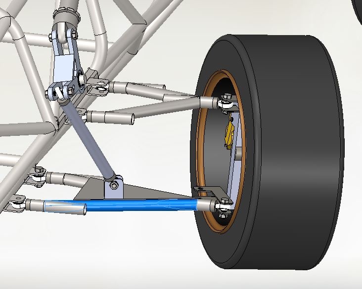

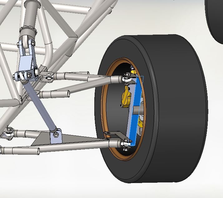

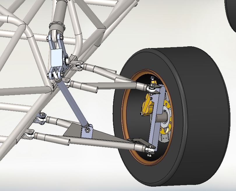

here is the assembly which i attempt to move
selecting the knuckle allows all part to move
if i select the arm, all assembly lock up.
