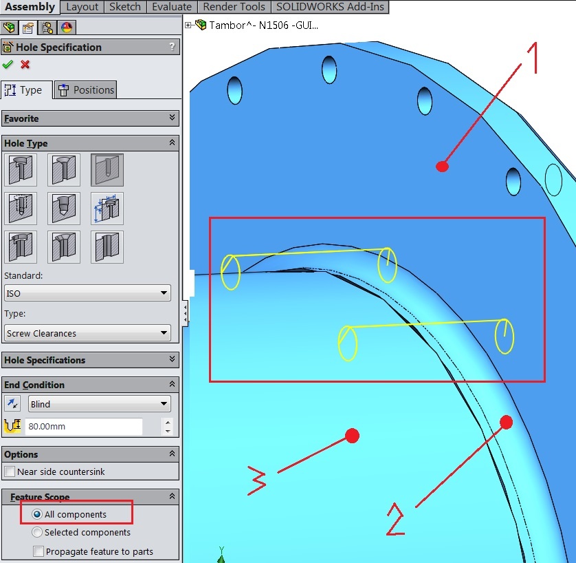

My problem is in an assembly, using the Hole Wizard. I have the SolidWorks 2015 (SP2) now, but the assembly was originally made on the SW 2014 (SP5).

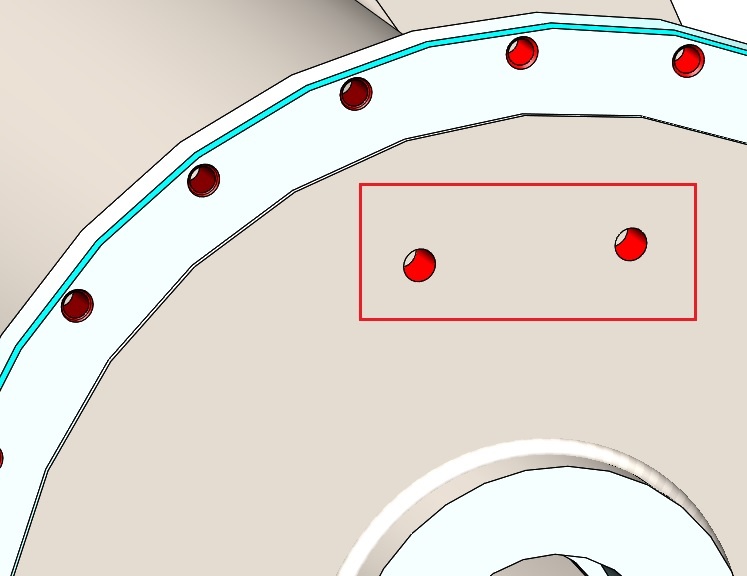

Describing the problem: I made a "blind" hole (with the Hole Wizard tool) that passes through 3 parts, initiating in a flange plane and then getting into other two parts. At the SW2014 version it worked okay, but now it does not remove material from the other two parts! (Fig.1 and 2) I tried selecting the Feature Scope in every way, did not work.
However, the Extrude Cut worked fine, but I want it to work properly!
