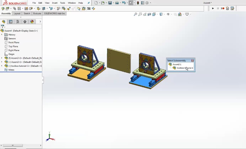

I'm working with an assembly that contains many levels of sub assembly. In the top level assembly i'd like to be able to be able to right click on screen on the sub assembly that i'm hovering over with the mouse to open it.
For example if i'm hovering over a bolt that is part of that sub assembly and click to select it and right click to open, it just opens the single base level component which is the bolt. It's such a pain having to scroll through the tree to find the assembly and open it from the tree.
Is there a setting or an option to have the select priority changed to assembly rather than base level part?
