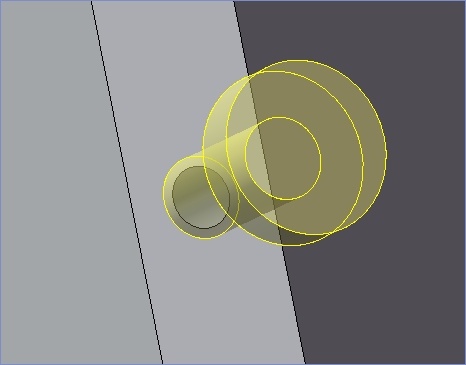

I have built may assembly and now at the end I am creating hole series to put the whole thing together. Hole series take a long time and really add to the rebuild time. The back part typically has a 1/4-20 blind thread and the front has a 1/4" binding head screw. Is there a faster way? It seems like my system is getting so sluggish I can go for lunch before it rebuilds.
