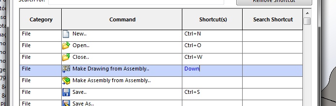

I'm experiencing some problems with the "Down Arrow Key" in my keyboard. I accidentally set it to a shortcut, as the example in the attached file. I've tried to just remove it but the key is not rotating the views anymore.
When I tried to reset the configurations to default, it started working again, but then, when I used the Copy Settings Wizard to set my old settings back, the Down arrow key stopped working once again.. This is driving me crazy, I don't want to lose my custom keys over this...
Anyone has a better solution than resetting to default and customizing it from zero all over again?
I've tried to find the entry on the "swSettings.sldreg" file that is generated by the Copy Settings Wizard to see what command was designating the Down Arrow Key not to work properly, but without success, can anyone help with that?
