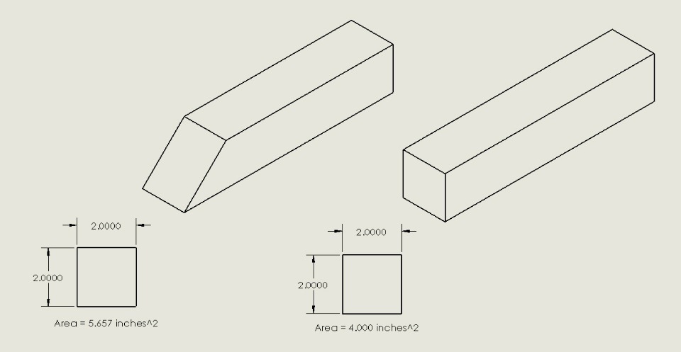

A co-worked asked me today how I approached taking the area from a part in a drawing. I said that I didn't, that I always took it from via the sketch section properties. He had been wondering why he got a different area when checking the area in a drawing front view of a mitered unit. See attached. I understand that the front view is still a mitered unit but it seems deceiving because the view looks the same as the unmitered unit. How do you approach this area scenario and do you have any advice in this regard.
