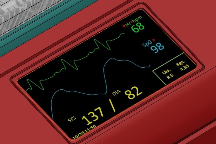

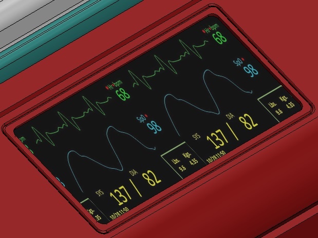

I'm applying certain appearance to a face of one of my components in order to make it look like a digital screen. Once I apply it and scale it in SW, I save it as a eDrawings file for presentation purposes. I set the mapping to surface, and the size/orientation to fit both the width and height of the selection. The problem is that when I open it in eDrawings, the appearance is changed, and doesn't matter if I scale it again, double the width of the image or anything else, change the mapping method, etc, the image simply doesn't fill the whole space.
Any ideas what could I do or why is this happening?
This is how it looks in SW
This is how it ends up looking in eDrawings
