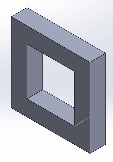

I have some questions regarding to SelectByID2 and SelectByRay method, let say I have a model and want to select an edge highlighted in the picture below:
Below is the sample code I used to do the selection:

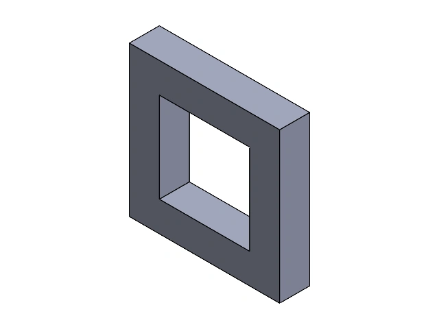

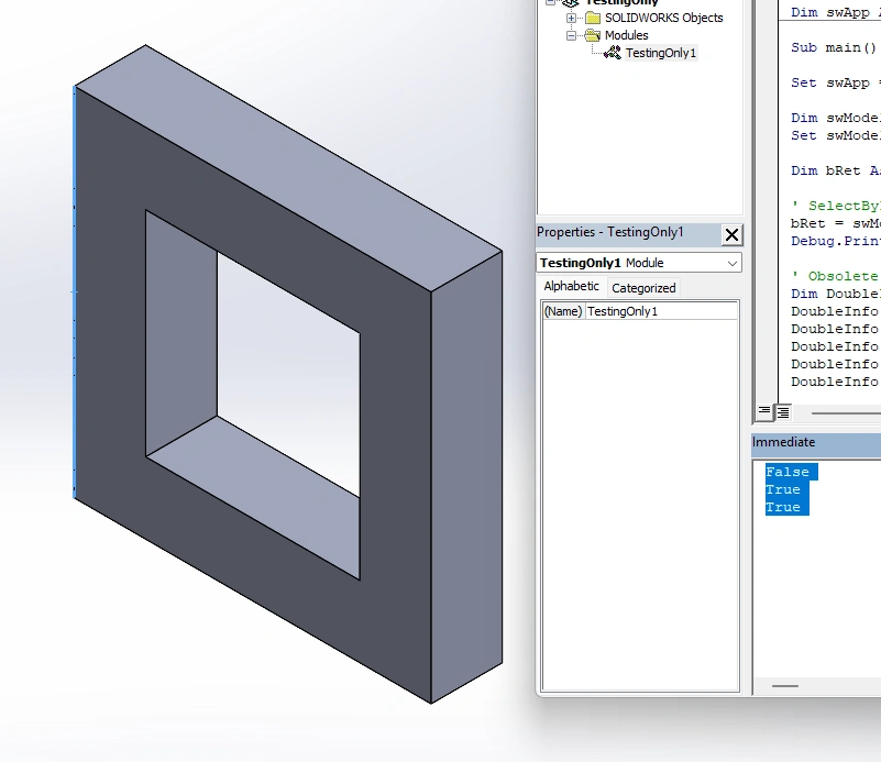

If the edge is in hidden behind another geometry, SelectByID2 method will fail.

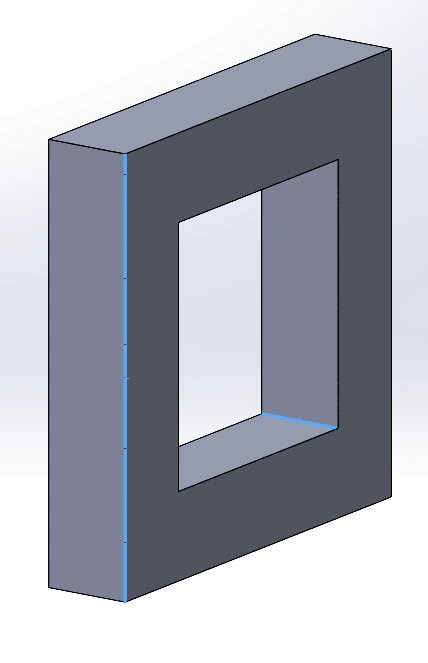

While both SelectByRay return true, but it is not the edge which I imagine it will choose. Post below describes the same issue that I am having, it is solved by using the obsolete method but only work on selecting face:
The SelectByID2 method will only return true when the model is oriented where the edge is visible.
May I know how to properly use the SelectByRay method to select edge? Attached is the sample model:
