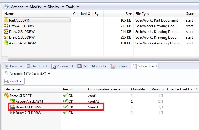

I am trying to write a code to retrieve all the drawings of a certain assembly.
The parts in this assembly have many configurations, each configuration has a separate drawing file.
I think I can use IEdmReference9::GetFirstChildPosition3 to find the assembly's parts, but the question is how do I find the correct drawings??
For example, a part has 2 configurations (and accordingly 2 drawings), but only one of them is used in the assembly.
"IEdmReference7::GetFirstParentPosition2" will return both drawings!
In the "where used" tab there is an indication if a specific configuration is used in the drawing, I marked it in the attached picture ("sheet1").
How can I get this information using API?
Thanks
