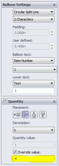

I am trying to read the quantity override value of an existing BOM balloon in a Drawing document, highlighted below:
  • An IBalloonOptions object allows you set this value and pass it to IModelDocExtension::InsertBOMBalloon2 which returns a Note, but this is for creating a new BOM Balloon.
  • The INote interface does not provide an obvious way to access the balloon options that created it.  Does anyone know how to do this?

Update: I figured out a workaround for the time being and wanted to post on the off chance somebody has the same issue.
I started adding watches to inspect the results of the various methods of the INote interface when a balloon was selected.  I discovered that a balloon with the "Quantity" checkbox shown returns a value of 3 when INote.GetTextCount is called.  When I call INote.GetTextAtIndex(3), it returns a concatenated string containing the quantity (or overridden value) and the Denotation string.
I haven't found a case where this information would not be stored at index 3, but it seems like a sort of hokey way of accessing that data.
Here is a simple macro I wrote to get the selected balloon so I could interrogate the object.  I just set a breakpoint on the End Sub line.
