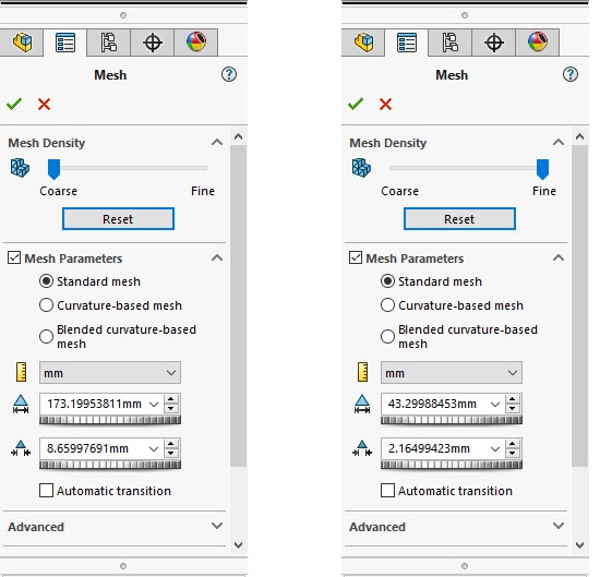

I'm trying to prepare several Frequency simulation studies via api to later run a bunch of them via c# ... and some how I want to use custom mesh density for these analysis ... I want to implement Something like Mesh Density TrackBar Setting that exist in Solidworks. (e.g. TrackBar  ==> Coarse(Min) --> +25% better than Min --> Default Element Size And Tolerance --> +75% better than Min --> Fine(Max) )
The question is how can I get Min/Max (Coarse/Fine) Element Size and Tolerance values for CreateMesh() function like in beneath image:

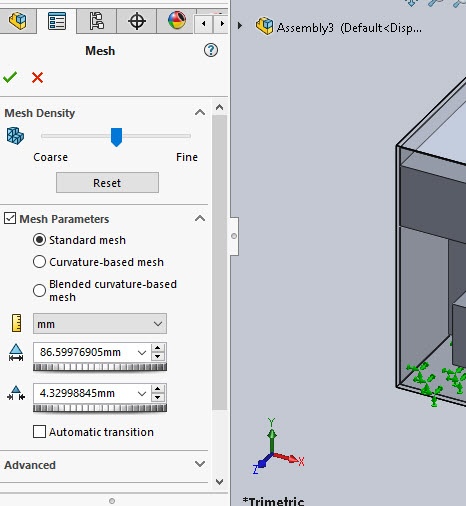

we can get Default Element Size And Tolerance  that shown in below picture :
but how I can get the Suggested value for Element Size And Tolerance values (shown in first image) in two Coarse and Fine scenarios ?
So I think If I don't know the correct range for these parameter (Are these values fix in solidworks setting or change Through the model shape or design ?... ) and pass manually some double value without any insight and hint I will face with serious troubles later ...
Here is my c# code for meshing the part that works correct for normal Density Mesh (Reset Button offer these config):
