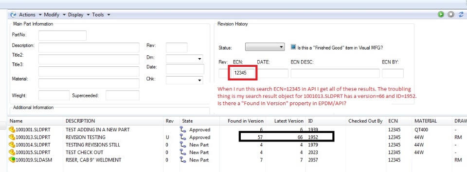

I have a variable called ECN and I want my search to return all latest versioned files that match a certain value, but my results include all versioned files. This wouldn't be so terrible if I had a way of checking if this is the latest version, then I could filter it... but the result object seems to have latest version/ID info.
My search result object ID/Version properties both list the latest version in the vault, but that is wrong. For example, when I do the search in EPDM... the version that is found is 57 (Found in Version) when the latest is 66. My API object version says 66 (see attached image)
Question: What is the best-cleanest method of running a search on EPDM and returning only the latest files? Again my search result object seems wrong... the version and ID are both the latest.
