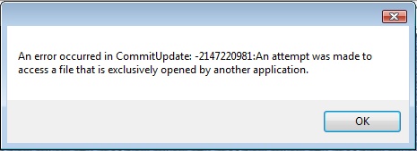

If I select a checked in file and move it through the transition, the OnCmd is called as expected, the form pops up and all is well until the CommitUpdate method is called.  The call fails with one error being returned. My handleCommitErrors method shows the following details:
Using ProcessMonitor I don't see any other process other than SolidWorks trying to access the file:

129055    10:25:58.8301479 AM    sldworks.exe    5676    CreateFile            C:\\_EPDM\\Part1.SLDPRT    ACCESS DENIED
SW successfully opens, closes, locks and unlocks the file prior to the CommitUpdate command.  At that point, the ACCESS DENIED occurs.
I added a bit of code to check the LockedByUser property of the file and it reports that the file is locked by my user.
Do I need to programmatically check out the file in order to call SetVar and CommitUpdate?
