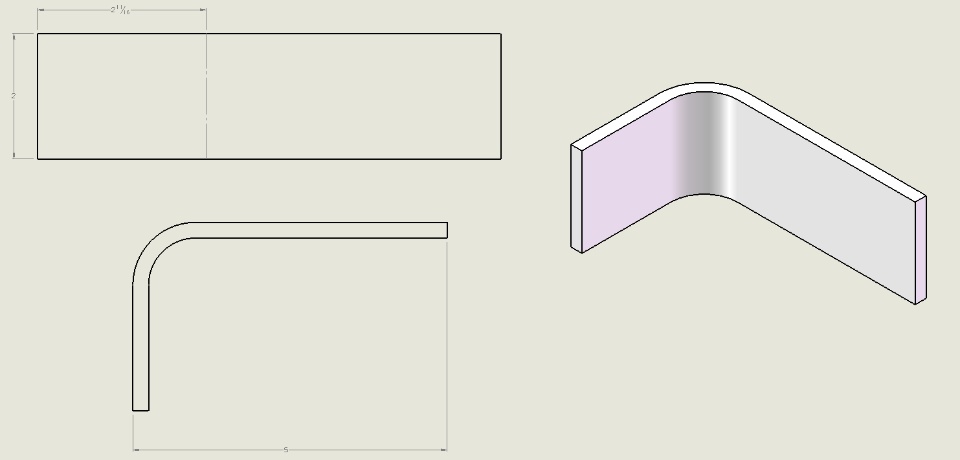

I am currently using a part with 200 configurations each possessing a flat. I need to create a drawing for each configuration, with the flat pattern and 2 other views (that aren't the flat pattern) that reference the same configuration as the flat pattern. I attached a picture to help explain.
I tried to use the first macro, "CreateDrawingsForAllConfs", I found in the forums, but it makes all three views only flats or only the part. The other macro "CreateDrawingsForAllFlatPatterns" also only creates flat drawings. While they both appear to be well made, I do not know enough about coding in this language to adapt them to my problem. Any assistance with this situation will be greatly appreciated.
