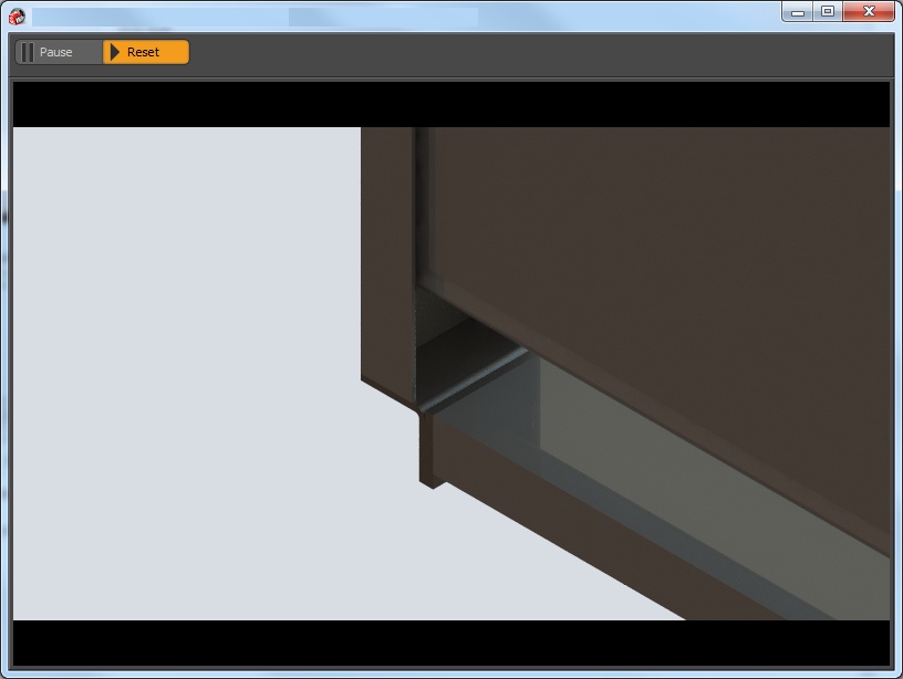

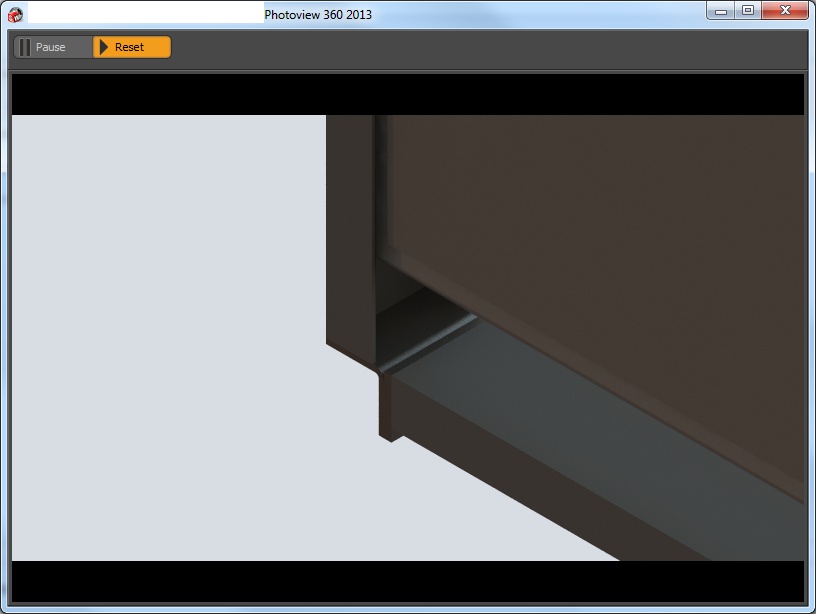

Anyone know how to turn off reflectivity?

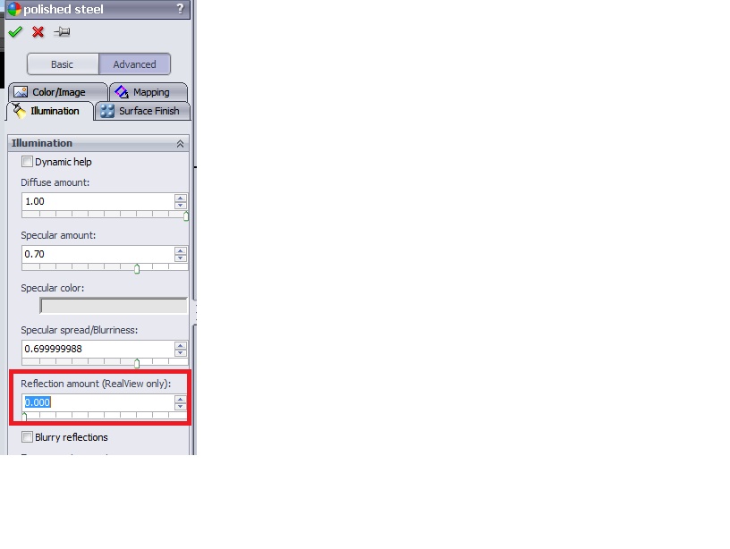

I have the following which appears to work but the setting changes back.
I am trying to turn off reflectivity for photoview renderings.

    Debug.Print "before  " & swRenderMaterial.Reflectivity
    swRenderMaterial.Reflectivity = 0#
    swModelDocExt.UpdateRenderMaterialsInSceneGraph True
    Debug.Print "after " & swRenderMaterial.Reflectivity
